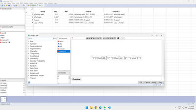

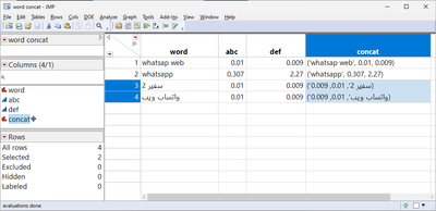

i have three columns - one character and two numeric - that i would like to concatenate into a long string as in the picture and the attachment.
for some reason, when the character is written in Arabic the concatenate results is in the wrong order.
"('" || :word || "', " || Char( :abc ) || ", " || Char( :def ) || ")"

what @Craige_Hales wrote made me think that the error in my case is order dependent so i tried changing the concatenation order as follows and it looks like it works but i am still not sure why and whether it is robust.

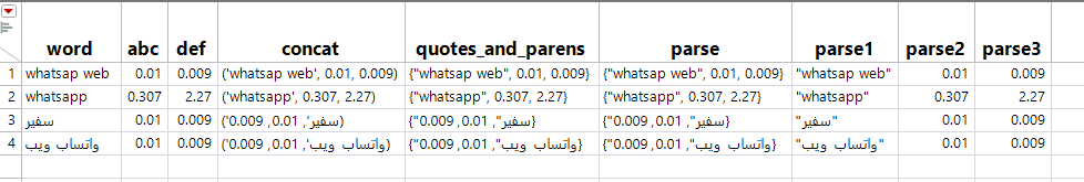

Please take a look at the attached table's extra columns and the formulas that create them.
Table with formulas to parse the Right to Left stringTable with formulas to parse the Right to Left string
The first four columns are the originals. quotes_and_parens uses substitute() to change the apostrophe to a quotation mark and the parens to curly braces. The parse column shows the output of parsing quotes_and_parens. At this point it still looks hopeless, but look at parse 1,2,3: they are extracting items 1, 2, and 3 from the list parse produced, in the order that makes sense.
Your solution, placing the RtoL string last, will work the same and is equally robust and has the advantage of displaying correctly.
The mis-displayed result is because of the Unicode rules for mixing and matching RtoL and LtoR strings. The error only happens when the string is displayed. The internal string is correct, and parsing it is probably fine. If SQL can't parse it, that seems odd and hard to explain, assuming SQL support Unicode otherwise.
I also found this confusing, especially when trying to select text that has portions of the selection reversed from other portions. Once I understood the reversing is being done at presentation time, it made more sense.
Craige

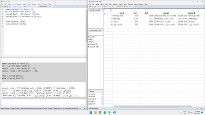

This issue is persistent also when i attempt to get the column as a list, in this case the string is twisted in a different way.
