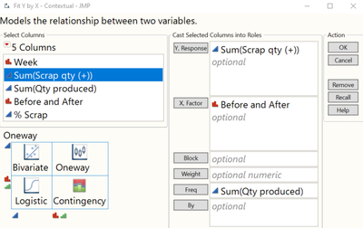

Looking for some insight on how to property analyze the data set attached to this post.  The company has been tracking the amount of scrap in pieces each week and the total number pieces produced to get a % scrap for each week.  The first 26 weeks are the baseline data, before any improvement actions were taken.  Weeks 27 through 31 represent the weeks after some improvement actions were taken.
It would be a mistake to use the overall average of the % scrap values in the Before and After group because the denominators in each row of the calculated percentages are different so I've used Summary to calculate the overall % scrap of the Before group and the After group as shown here:
The % scrap values for both groups are close so it doesn't look promising for us to detect a significant difference between the two groups.  My specific question is what is the best way to calculate that (lack of) significance?
I'm also wondering if I should treat Qty Produced as a frequency column since each weeks that produced hundreds of parts should contribute more to the data set than weeks that only had 2 parts produced.  Without incorporating frequency when we run 2 parts and have 0 scrap that is treated the same as a week where we run 142 parts and have 0 scrap.  If I use the fit Y by X platform and put qty produced in Freq I get a significant result, with the Before group showing more instances of scrap on average than the After group.

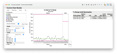

As @P_Bartell mentioned, it is probably best to start with a U-chart to see a shift in % scrap over time. WK as X, % Scrap as Y and Before and After as Phase in control chart builder.  IF you think you have enough weeks data collected for after and seen a shift downwards, then there is probably a positive change in the process.

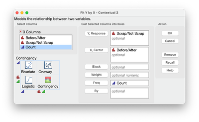

You are on the right path for using fit Y by X for contingency analysis. The data entered is not quite correct.  You need a stacked table. X would be Before/After and Y would be Scrap/Not Scrap and the frequency would be count.
To do this, you would first subtract Scrap qty from Qty Produced to get Not Scrap count. This can be done by selecting both columns the using a right click and choosing New Column Formula>Combine>Difference (reversed order)
I renamed the columns to Before/After, Scrap and Not Scrap.

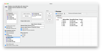

Next is to summarize Scrap and Not Scarp using Sum within Summary under tables and using Before/After as Group (this is similar to what you have done before). Then stack Sum(Scrap) and Sum(Not Scrap) so you now have 3 columns (using Stack under Tables menu)
Now you can use the new table for Fit Y by X like you did before.

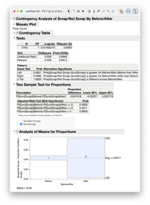

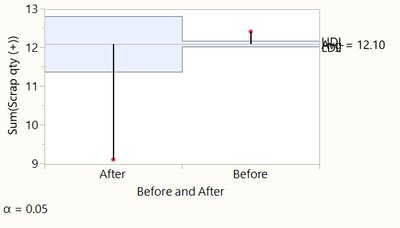

If you then use Two Sample Test for Proportions and also look at analysis of means for proportions, it will look like there is no difference, but the after decisions limits are quite wide due to the sample size and the first two weeks being higher than the next three weeks (a trend in the data).
I would not trust this result due to the trend in the data as seen in the U-chart above (as @P_Bartell mentioned is the first step). But I think the U-chart is telling that something is beginning to happen with the change in process and is worth showing if some evidence is needed for preliminary validation of the process change is having an affect.

If you have access to the weekly data I suggest a p chart control chart approach since you know the point in time when the process changed. And to be absolutely clear...if 'statistical significance' is of paramount importance to you...a control chart is not a statistical inference method. But if you have the weekly data...that's where I'd start. Stare at the chart for no more than 3 seconds. If you don't see a shift in the line...it's not there. Otherwise you'll start talking yourself into to supporting whatever your prevailing/hoped for point of view.
