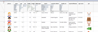

I have two tables, this small table determines the columns I wish to keep
My other table has much more data but I need to just get those columns

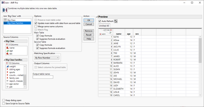

you can use Join to basically overwrite the values is smaller table

Ah… I think join works the best few clicks…you all are amazing.
