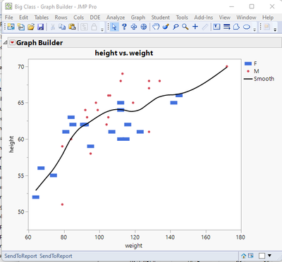

color settings for "missing" values
If there is a value missing in the data table, "missing" shows up as the first entry in the legend - and shifts all colors by 1 :(
Is it possible to define the value order in the column preferences such that "missing" is last?
Is it possible to define this as a standard via preferences?
Or even better: Is it possible to define a fixed color for "missing" values - such that it doesn't interfere at all with the standard color order?

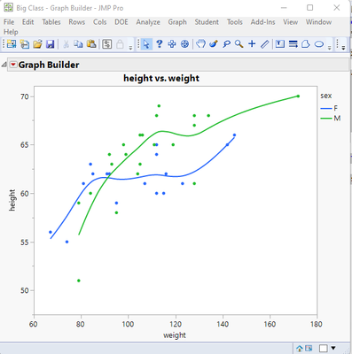

Re: color settings for "missing" values

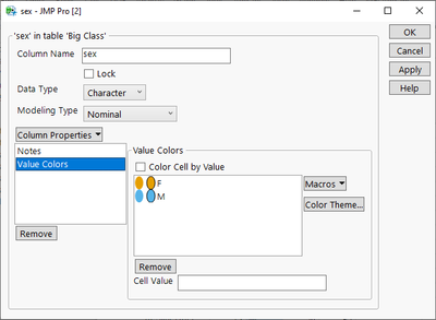

What you need to do is to set the Value Colors for the column in question.  The limitation is that you do not want to use the #1 color in your choice.  Reserve that for the Missing Category
names default to here(1);
:sex << set property("Value Colors", {"F" = "blue", "M" = "green"});

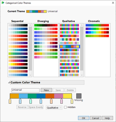

jthi

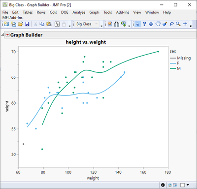

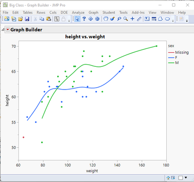

You could use Value Colors column property but... if you use it it seems like the missing value color in the theme will be ignored. I would say this is a bug and should be reported to JMP support.
By default the user's preference color theme should be used AND the missing values should be with the desired color, but for some reason this doesn't seem to be the case
With Value Colors (missing color will be ignored)
Without Value Colors (weird shift as the missing color is used but first color is still skipped)
I'm using Universal color theme here
-Jarmo

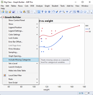

txnelson
Apparently you have the option, "Include Missing Categories" selected as your default.  You can tun this off by unselecting it under the red triangle.
Or the option can be set as a default  as a preference
The order of Missing Categories can also be adjusted under the "Legend Settings" selection under the red triangle
Jim

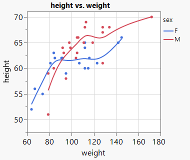

hogi
Level XIII
Hi Jim,
thanks for the explanations.
To be honest, I don't understand which part of it solves my problem:
 I face this problem very often in JMP and want to solve it in general.
Below is another example, which makes the problem slightly more visible:
"sex" and "sex_2" are "the same", there is just one value missing in one cell of the data table.
I expect the color schemes to be the same (*) "by default" - without any additional effort.
How can I configure JMP to make it behave like expected (*)?

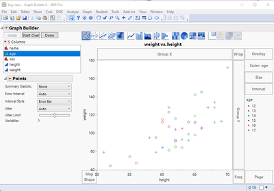

There is not an equivalent "Value Markers" to the "Value Colors".  Markers are set either by Row State
Names Default To Here( 1 );
dt << Marker by Column( :sex );
Graph Builder(
	Variables( X( :height ), Y( :weight ), Color( :age ) ),
	Elements( Points( X, Y, Legend( 1 ) ) )
Or by specific changes to elements within the Graphic platform
Graph Builder(
	Size( 525, 454 ),
	Show Control Panel( 0 ),
	Variables( X( :weight ), Y( :height ), Color( :sex ) ),
	Elements( Points( X, Y, Legend( 9 ) ), Smoother( X, Y, Legend( 10 ) ) ),
	SendToReport(
		Dispatch(
			"400",
			ScaleBox,
			{Legend Model(
				9,
				Properties(
					0,
					{Marker( "FilledWide" ), Marker Size( 6 )},
					Item ID( "F", 1 )
Jim
