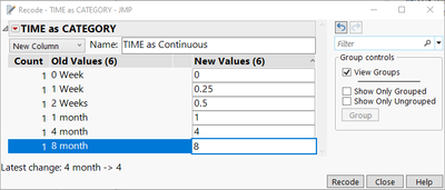

How the recode dialog should look like before any changes:
Recode dialog with new values updated

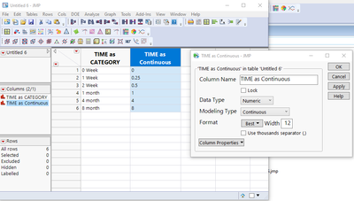

Finally, in the Column Info window, how the Data type and Modeling type should look like:
Let me know if that does not work either.

Hi, One the simplest method is to create a new X column with the duration as continuous values on a scale of weeks or months whichever is more appropriate to your application.
I would recommend using the Recode function based on your original X values, then change the data type to Numerical and modelling as Continuous.

Hi Thierry,
As a new JMP user I don't have the full knowledge about the recode feature. I have attempted recoding the column to something such where 1 week=0.25 months, 2=0.5 months and then months as whole numbers. Then once i change the modeling type to continuous and try graphing, the 2 fractional x values appear after 12 months so it reads 1-12, 0.25, 0.5. Maybe this isn't what you suggested, but could you give me a little more direction on the recode?

Here are a couple of screen captures to show you the steps:

Re: change size axis increments based on time
Thank you that did fix the issue with the axis order. Was there a way to distort the axis values themselves so that the time is misinterpreted? Such as the gap between 5 and 6 is the same as 6 and 9 although the time between the two is significantly different. I have included grid lines here, but I mean to pinch the 0 and 0.25 values closer together along the x axis and stretch the 9 and 12 to more accurately show the time spread. Maybe this isnt possible in JMP?

Hi,
I'm not sure what you are doing but it seems that the Modeling Type of your X column (i.e., Continuous Time) is still incorrect: from the image you shared it still looks like it is Ordinal or Categorical, it should be Continuous.
I have solved the issue after going back through it again. Thank you for your help!
