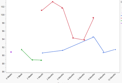

I am plotting data over time using an uneven spread of intervals (1 week, 2 weeks, 1 month, 6 months, etc). I would like to make it so the increments on the x axis are sized proportionally to the amount of time; 0-1 weeks, 1-2 weeks being the smallest and 6-9 months, 9-12 months being the largest.

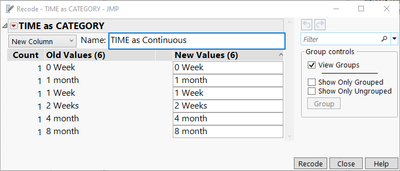

Hi, One the simplest method is to create a new X column with the duration as continuous values on a scale of weeks or months whichever is more appropriate to your application.
I would recommend using the Recode function based on your original X values, then change the data type to Numerical and modelling as Continuous.

ohaynes
Level II
Re: change size axis increments based on time
Hi Thierry,
As a new JMP user I don't have the full knowledge about the recode feature. I have attempted recoding the column to something such where 1 week=0.25 months, 2=0.5 months and then months as whole numbers. Then once i change the modeling type to continuous and try graphing, the 2 fractional x values appear after 12 months so it reads 1-12, 0.25, 0.5. Maybe this isn't what you suggested, but could you give me a little more direction on the recode?

Thierry_S
Hi,
That's odd.
Here are a couple of screen captures to show you the steps:
How the recode dialog should look like before any changes:
Recode dialog with new values updated
Finally, in the Column Info window, how the Data type and Modeling type should look like:
Let me know if that does not work either.

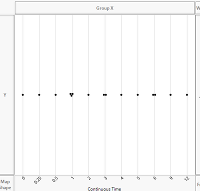

Thank you that did fix the issue with the axis order. Was there a way to distort the axis values themselves so that the time is misinterpreted? Such as the gap between 5 and 6 is the same as 6 and 9 although the time between the two is significantly different. I have included grid lines here, but I mean to pinch the 0 and 0.25 values closer together along the x axis and stretch the 9 and 12 to more accurately show the time spread. Maybe this isnt possible in JMP?
Thierry_S
Hi,
I'm not sure what you are doing but it seems that the Modeling Type of your X column (i.e., Continuous Time) is still incorrect: from the image you shared it still looks like it is Ordinal or Categorical, it should be Continuous.
