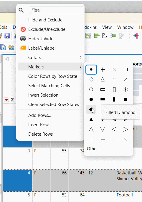

Another option:
Via right click - assign a Row State/Marker to the selected columns.
The disadvantage of this approach: row states are static, they don't adapt interactively to the current data!
