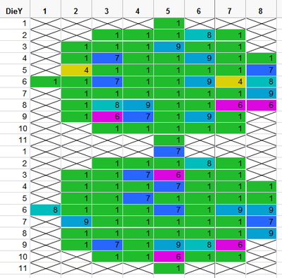

can we color the cells in jmp table as we do in excel? I mean really give colors to the part of table/cells interested
can we color the cells in jmp table as we do in excel? I mean really give colors to the part of table/cells interested?
I tried below jsl but it only works when you plot the data in graphs but not in the table itself?

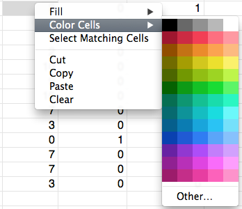

In JMP 9 and beyond try right clicking on a cell in a data table and you'll get a menu that will let you color the cell.

I got the hint and was able to get my wafer map colored by Bin(value). I did not know the color by cell value is off by default. Have not figure out how to tell jmp do nothing if the cell value is empty.

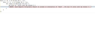

finally I got it to color only non-empty cells with desired colors. but there is still an error though the script is executable.

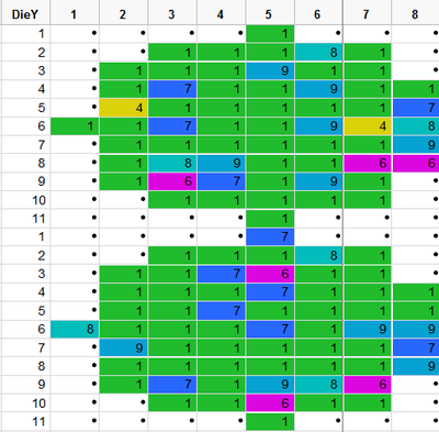

your script is much simpler but it is not able to exclude the empty cells(showing X)
my script trying to send color cell by value to a cell, which works but giving below error. Do you know what the error tells us and how to debug it?

My code excludes the empty cells with the ! is missing() check.  I only get the X's for empty cells when I use a Value Gradient.
Your code is failing because that method expects a column, not a cell.  Again I strongly recommend that you change j to k or something because j is a function in JSL.
I realized that the color cell by value method only needs to be called once per column, so I took it out of the k loop.
