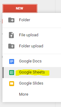

steps to make a google sheet: pick new:
pick sheet:

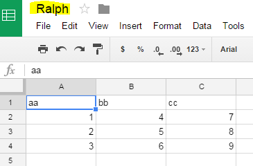

give it a name...

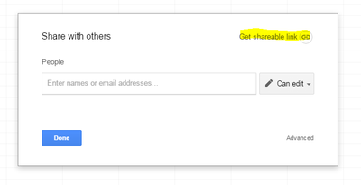

pick share:
ask for a shareable link.  I did not choose anybody for editors.  It is shared with the world if you have the link.  I think this is where you can restrict viewers as well.
copy the link.  As you can see, this doc is open to the world...

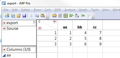

finally, use the JMP open function (JSL) to view it.  (Or use File->InternetOpen->OpenAs->Data with the same URL)
open("https://docs.google.com/spreadsheets/d/1A...........7E/export?format=csv&id")
