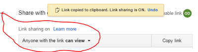

pick share:
ask for a shareable link.  I did not choose anybody for editors.  It is shared with the world if you have the link.  I think this is where you can restrict viewers as well.
copy the link.  As you can see, this doc is open to the world...

I tried same steps as above. but could not access it through jsl.
the only dfference i could see is, that here" anyone can view"
where in my case i have " anyone at company an view"
and it gives a error "Unable to read data from"
