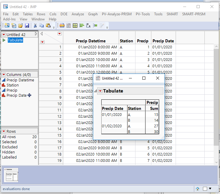

If you are trying to calculate the sum of precipitation for a given day/station, create a new column which is just the date part of the datetime.  Then do a tabulation by date and station, and put Precip in the middle.
This program creates an example dataset with a formula column for date and a Tabulate program to calculate the precipitation by date/station.
New Table( "Example", Add Rows( 20 ),
	New Script( "Tabulate",
		Tabulate(
			Show Control Panel( 0 ),
			Add Table(
				Column Table( Analysis Columns( :Precip ) ),
				Row Table( Grouping Columns( :Precip Date, :Station ) )
	New Column( "Precip Datetime", Numeric, "Continuous", Format( "ddMonyyyy h:m:s", 22, 0 ),
		Input Format( "ddMonyyyy h:m:s", 0 ),
		Set Values(
			[3660710400, 3660714000, 3660717600, 3660721200, 3660724800, 3660710400,
			3660714000, 3660717600, 3660721200, 3660724800, 3660796800, 3660800400,
			3660804000, 3660807600, 3660811200, 3660796800, 3660800400, 3660804000,
			3660807600, 3660811200]
		Set Display Width( 186 )
	New Column( "Station", Character, "Nominal",
		Set Values(
			{"A", "A", "A", "A", "A", "B", "B", "B", "B", "B", "A", "A", "A", "A",
			"A", "B", "B", "B", "B", "B"}
	New Column( "Precip", Numeric, "Continuous", Format( "Best", 12 ),
		Set Values( [1, 2, 3, 4, 5, 3, 4, 5, 1, 1, 4, 5, 6, 7, 5, 4, 5, 6, 7, 8] )
	New Column( "Precip Date", Character, "Nominal",
		Formula( Short Date( :Precip Datetime ) )
pmroz
