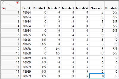

Sort Columns in Descending Order and use 4 largest for calculation
I have a data table and I need to get the first 4 largest values from a range of columns, labeled "Nozzle #". These column values vary by variable, or column labeled "Test #".
I then need to apply these values and in a new column calculate area of a circle per test #. Since I have a larger data table, I would like to either group the columns using the For, If, and Contains logic or is there a more efficient approach in JSL?

I would like the first 4 largest Nozzle values per test. So, it would be:
18684 = 5.5 5 4 0
18685 = 5 5 4 0.5
18688 = 5.5 5 4 0.5
18689 = 5 5 0.5 0

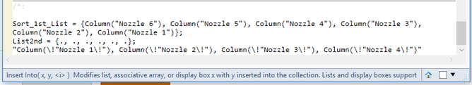

Re: Sort Columns in Descending Order and use 4 largest for calculation
So I tried putting the columns into a list using a for loop, shown as List1st in the nozzle_script.jsl file. Whenever I try sorting them, only the column names are sorted and not the column values. I also tried using the code you have shown and the lists are shown as empty in the Log, shown below.

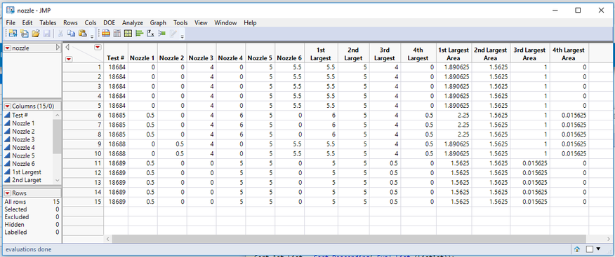

My overall goal would be something like this:
(note: I manually entered the "Largest" column values. Then applied ("Largest"/4)^2 formula for the "Area" columns.)
I have attached the data table and my script below. Thank you!

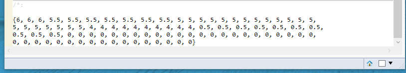

Tried it out, code shown below, but it gives me all the values sorted.

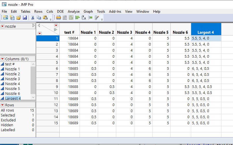

txnelson
Please take a look at the first formula I gave you.  It first creates a list of all of the values for the different columns for the given row.  It then sorts the values and finally it takes the first four values into a character string.
If you add that code to the latest code, it will result in a value for the column that contains the first 4 largest values.
