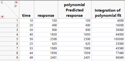

What if the expression used by Integrate needs to be extracted from the formula in a column, for example to Integrate using a formula from a polynomial fit.
In the table below, the formula in the predictor column would use  :time and :response. Is there a quick syntax to replace the column names with new variables?
