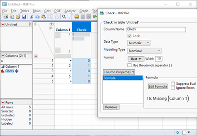

jthi
Re: binary recoding
Just using Not(IsMissing()) should be enough
Names Default To Here(1);
dt = New Table("Untitled",
	Add Rows(5),
	Compress File When Saved(1),
	New Column("Column 1",
		Numeric,
		"Continuous",
		Format("Best", 12),
		Set Values([., 2, ., 5, .])
dt << New Column("Check", Numeric, Nominal, Formula(
	!IsMissing(:Column 1)
And if you want to have then as characters wrap that with Char()
Char(!Is Missing(:Column 1))
-Jarmo

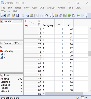

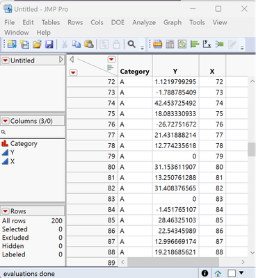

txnelson
Re: binary recoding
I would use a simple script to do the change.
If you have a column of data that contains zeros and other values
You can use this simple script to change the values
For Each Row(
If( :Y == 0, :Y = 0, :Y = 1 )
Jim
