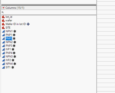

Hello,
Is there a way to use contain to search the column properties and group them if only the column contains spec limits properties?
Trying to group the columns that contain the column property "Spec Limits". Any advice?
Thanks,
Jackie

txnelson
Re: Group columns containing column properties
You just need to go through the numeric columns and put into a list, the ones with Spec Limits.  Then use the Group Columns message to create the group
Names Default To Here( 1 );
dt = Current Data Table();
theNames = dt << get column names( numeric, string );
specLimitsList = {};
For Each( {colName}, theNames,
	If( Is Empty( Column( colName ) << get property( "Spec Limits" ) ) == 0,
		Insert Into( specLimitsList, colName )
dt << group columns( "HaveSpecLimits", specLimitsList );
Jim
Ressel
Level VII
This should work on your example table:
colList = dt << Get Column Names();
For( i = 1, i <= N Items( colList ), i++,
	If( Contains( Char( (Column( i ) << Get Column Properties( string )) ), "Spec" ),
		Column( i ) << set selected
dt << group columns( "name of your group" );
2 REPLIES 2
