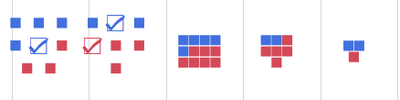

Is it possible to use 🗹 as a marker?
Instead of the entered symbol, JMP display a questionmark :(

Might need to use different character
Names Default To Here(1);
dt = open("$SAMPLE_DATA/Big Class.jmp");
dt << Select Rows(1::10);
dt << Markers("☑");
dt << clear select;
dt << Select Rows(11::20);
dt << Markers("\!U2611");
dt << clear select;

Re: 🗹 as a marker
Hi Jarmo, thanks :)
Any block with a non-standard marker gets shows a much larger spacing :(
interesting, why?
Do you think there is any chance to prevent it?

I cannot replicate the same situation you are getting. Maybe you can change Jitter spacing from Customize menu for Markers
-Jarmo

Thanks for the hint.
Jmp 17:
TS-00138714
