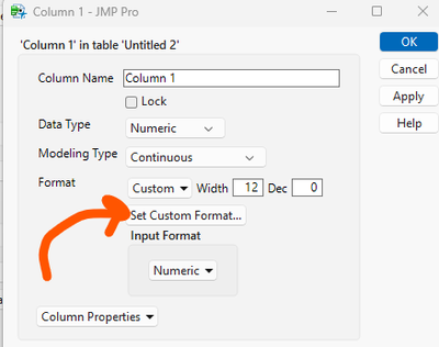

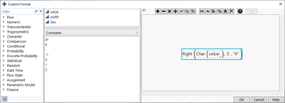

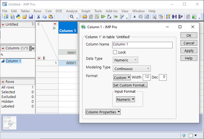

For anyone else looking at this, you click here to get the formula editor for the format you want to use:
Thanks again!
