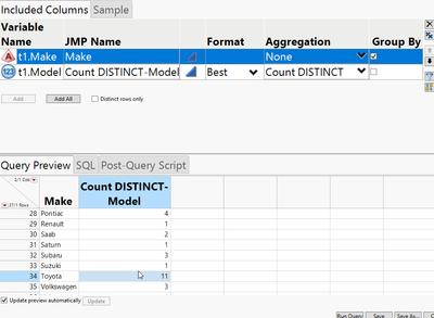

This is also possible under JMP Query Builder, for example.
SELECT t1.Make, COUNT(DISTINCT t1.Model) AS "Count DISTINCT-Model"
FROM Cars t1
GROUP BY t1.Make;

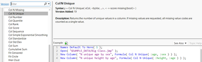

Re: Formula column to obtain unique values using grouping columns
available now:
