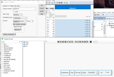

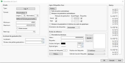

Hello,
Thank you for your quick reply. Now it is like this. Do you think it is possible to adapt the formula to have this representation? 3.4 × 10⁵ ? Without the ^, but with the number in the exponent ?

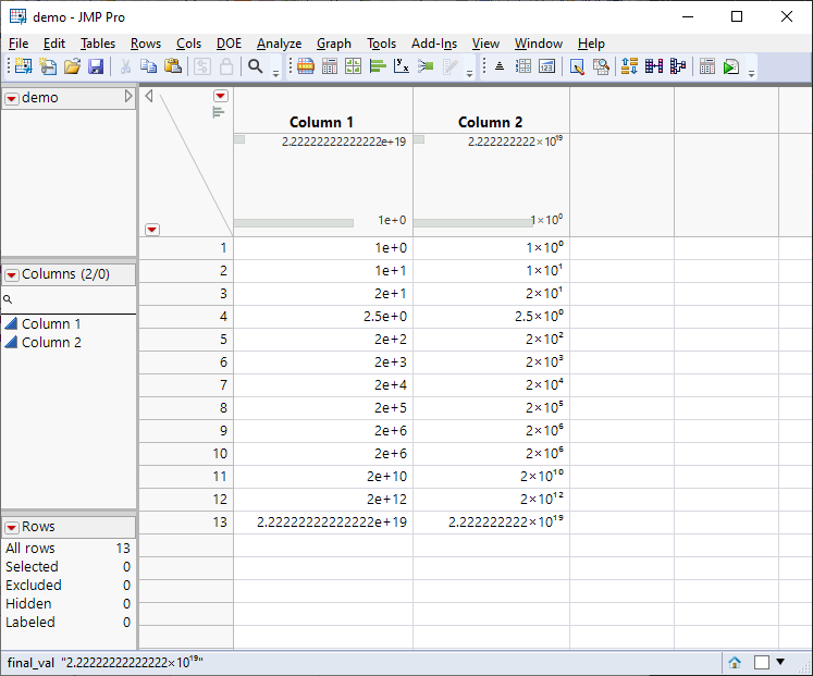

Names Default To Here(1);
dt = New Table("demo",
	Add Rows(13),
	Compress File When Saved(1),
	New Column("Column 1",
		Numeric,
		"Continuous",
		Format("Scientific", 64),
		Set Values(
			[1, 10, 20, 2.5, 200, 2000, 20000, 200000, 2000000, 2000000, 20000000000,
			2000000000000, 2.22222222222222e+19]
		Set Display Width(155)
	New Column("Column 2",
		Numeric,
		"Continuous",
		Format(
			"Custom",
			Formula(
				keys = {"0", "1", "2", "3", "4", "5", "6", "7", "8", "9"};
				values = {"⁰", "¹", "²", "³", "⁴", "⁵", "⁶", "⁷", "⁸", "⁹"};
				superscripts = Associative Array(keys, values);
				valstr = Format(value, "Scientific");
				exp = Word(-1, valstr, "+");
				e_sup = Transform Each({e_val}, Words(exp, ""), superscripts[e_val]);
				exp_superscripts = Concat Items(e_sup, "");
				val = Word(1, valstr, "+");
				final_val = Substitute(val, "e", "×10" || exp_superscripts);
			64,
			0
		Set Values(
		Set Display Width(134)
-Jarmo

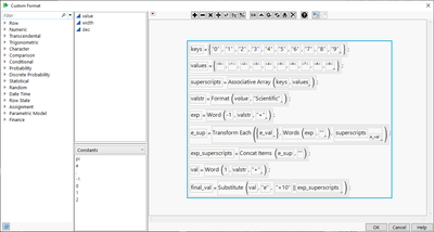

Open your column properties (right click -> column info, or just double click on the header)
From format go to Custom
Then click Set Custom format. On the (formula) editor copy and paste
values = {"\!U2070", "\!U00B9", "\!U00B2", "\!U00B3", "\!U2074", "\!U2075", "\!U2076", "\!U2077", "\!U2078", "\!U2079"};
click ok to close the editor. Then apply and OK to apply your format
-Jarmo

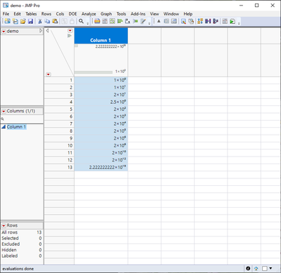

Emmerich38
Level II
Re: How change "E" for powers of 10
Thanks a lot, I copied your script in the custom section over the graphic and it works.
Have a nice day!

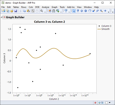

There is also blog postReply All: Scientific notation such as 6.02×10²³ using custom axis formats which has different custom formula which also takes the negative exponent into account. Here is my modified version of the version from the blog post by Xan (biggest change is to use Words() in Substitute Into to remove need for loop).
For scripting this can be used
Local({
	supers = "⁰¹²³⁴⁵⁶⁷⁸⁹⁻",
	numbers = "0123456789-",
	numpart, exprpart
	supers = "⁰¹²³⁴⁵⁶⁷⁸⁹⁻";
	numbers = "0123456789-";
	{numpart, exppart} = Words(Format(value, "Scientific", width, dec), "e+");
	Substitute Into(exppart, "+", "", Words(numbers, ""), Words(supers, ""));
	If(value == 0,
		"0";
		numpart || " × 10" || exppart;
And for easy copypaste this works (locals not used)
If(value == 0,
	"0";
-Jarmo
