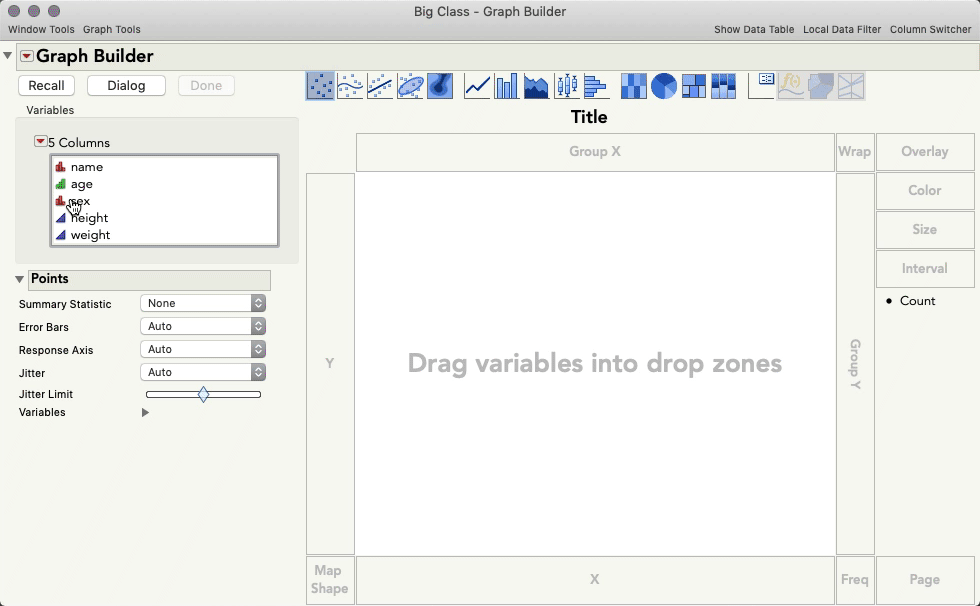

If you absolutely need a plot that sizes the X-axis uniformly irrespective of the distribution of X, it won't be a mosaic plot. But, you can make such a plot in Graph > Graph Builder, by placing your Y variable in the Y Role, and your X variable not in the X-Role, but in the Group X role at the top. Then, toggle the mosaic plot at the top to make a mosaic-like plot.
