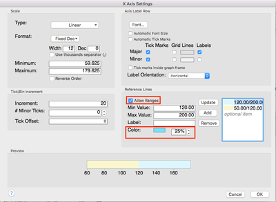

Jeff_Perkinson
Re: X,Y scatter plot with coloured zones
Ian@JMP​ has a good idea.
Another option in JMP 12 is to use the new color and range options in the Axis specification dialog to do this.
Double click on the axis and then use the Allow Ranges and Color options in the Reference Lines section.
-Jeff
-Jeff
