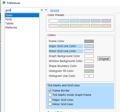

Is it possible to save this preference and make it the default for the x-axis when I'm using graph builder? I specifically need the Show tick label, long divider, show grid, and lower frame to be like this in default. Thanks.
If you go to the Column Info for the x-axis variable and choose the Axis property, I believe you can set all of the properties that you want. Whenever that variable is used in a graph, those axis properties will be utilized.
I have not found a way to save these properties for the use of ANY nominal x-variable. Perhaps another community member has found a way to do it. My only suggestion is to copy the axis settings from a variable that was set and then paste to any other column that you want to use on the x-axis.
I don't think there are preferences for those which would only apply to Graph Builder. You can change preferences but it would apply to all platforms and columns
