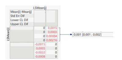

2. It should go to the crosstab and take from the second column, row 1, row 3 and row 4 (Mean[i]-Mean[j], Lower CL Dif and Upper CL Dif).
Please see picture below.
The mean difference is printed with this line
meandiff = Round( crossTab[1, 2] , 3 );
It should be rounded to three decimals and it should be rounded according to normal rounding rules. It just did not round correctly and I cannot figure out what goes wrong.
Best regards,
Julie

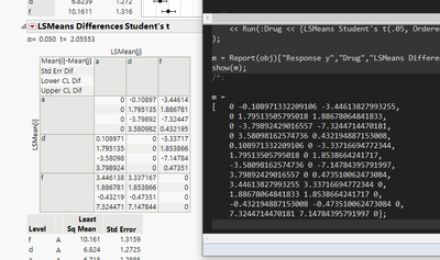

Did you check the values it really has? Those values you see in the JMP report are most likely already rounded values. This is done in JMP18
Names Default To Here(1);
dt = Open("$SAMPLE_DATA/Drug.jmp");
obj = Fit Model(
	Y(:y),
	Effects(:Drug, :x),
	Personality(Standard Least Squares),
	Emphasis(Effect Leverage),
	<< Run(:Drug << {LSMeans Student's t(.05, Ordered Differences Report(1))})
m = Report(obj)["Response y","Drug","LSMeans Differences Student's t",CrosstabBox(1)] << get as matrix;
show(m);
-Jarmo
