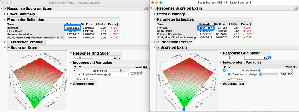

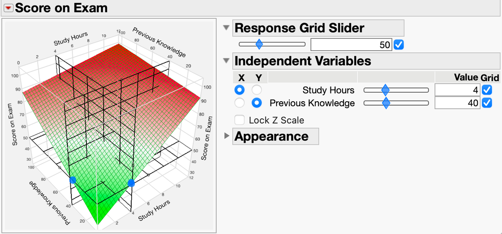

I always find it helpful to see these things visually. Here's that example I used before, and let's look at the regression planes (which will be the same) for the centered polynomial model (left) and the uncentered model (right). I've added in a response grid at 50 for both (which is the intercept of the centered model). I have also put blue dots to show where the intercepts of the models are
Starting on the right, the intercept has a very easy interpretation. It's the value of Y where the plane of the response crosses 0 for both X1 and X2. That is, when there is 0 of study hours and 0 of previous knowledge. Easy.  (Important for later: we aren't even thinking about the interaction term here because in this kind of model, when X1=0, and X2=0, we know that the interaction adds nothing because that b3 coefficient is being multiplied by zeros)
For the centered model on the left, the model intercept of 50 is well above the value when there is 0 of both Xs. But why the bump of roughly 20 exam points?
A score of 50 is where we have roughly 40 of Previous Knowledge and 0 Study Hours; or, where we have 0 Previous Knowledge and 4 Study Hours. Here I've toggled on the value grids so you can see them line up with the blue dots I put before:
So, what gives?! We know these are not the means of Previous Knowledge and Study Hours, so it's not as simple as holding one variable constant and the other at their mean. One thing might pop out to you here: these points are a symmetric distance up the plane of response from the "true" (X1=0, and X2=0) intercept. And the only term in our model that exerts symmetric influence (in a scaled sense) on Y across the factors of X1 and X2 is b3, the interaction term.
What we're not accounting for yet is setting the *interaction* term, B3, to 0. And that zero happens at a different place in a model like this than where X1 and X2 are 0 (because of that centering); it happens at the means of X1 and X2, so we're talking about *average* interaction. The intercept of 50 here reflects a kind of adjusted baseline: it's what we would get at (X1 = 0 or X2 = 0) if there were no interaction effect in the population. Conceptually, an estimate the intercept adjusted for the presence of the interaction.
To me, this term resists a conceptual interpretation quite a bit more than any typical intercept but here's how I would frame it in this case: With the negative coefficient for the interaction term, we know that these factors are interacting antagonistically (more of one decreases the strength of the relationship between the response Y, and the other factor). That is, the more people know ahead of time, the less they get value from studying on average. Or, the more people study, the less on average they get value from how much they knew. The intercept in this model is trying to tell us what exam scores would be like *if that were not the case.* If that interaction weren't the state of the world we measured, then people who studied 0 hours would have had more value from their previous knowledge, and so they would do better on the exam, a bump up from an intercept of 30 to 50. And if that interaction weren't the state of the world we measured, then people who had 0 previous knowledge would have had more value from their studying, hence that same bump up of the intercept from 30 to 50. Like an ANCOVA, this is a statistical "as if" thought experiment.

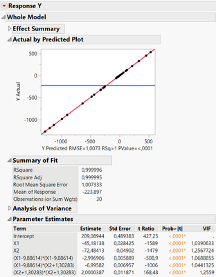

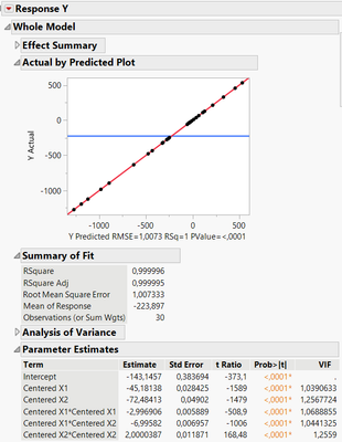

I have prepared a dataset with two factors X1 and X2, a response with predetermined response surface equation Y, and two calculated columns for centered X1 and centered X2.
When launching the model fitting with original variables and a response surface model, you can see that JMP does not center original variables, but do it with variables involved in interaction or polynomial terms :
When launching the model fitting with centered variables and a response surface model, you can see that parameter estimates are the same between Xi and centered Xi, intercept is different but parameter estimates are the same as before :
Centering variables doesn't change the coefficients of the corresponding main effect estimates (the "slope" is the same wether you're centering the variable or not), so the interpretation stays the same.
So I think this use case and demonstration answer your 2 questions (I'm not sure tu understand the problem with your 2nd question) ?

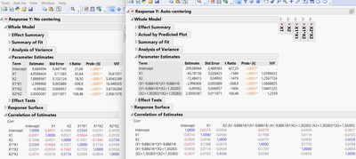

Relaunching the tests, here are some results for the estimates correlations :
On the left, model version without "auto-centering of polynomials". You can see high VIFs for X1/X1² and X2 effects. Looking at correlation of estimates, you can see you have strong correlations between X1 and X1², X2 and X1*X2 parameter estimates, as well as inflated standard error for these main effects parameter estimates.
On the right, model version with auto-centering of polynomials. You can see low/acceptable VIFs for all effects (< 2), and even if some effect estimates are correlated, you avoid trivial correlation between parameter estimates (for example between the X1 and X1² effects estimates). The auto-centering avoid inflation of parameter estimates that share the same original variables (for example main effect and polynomial effect of X1).
I agree that the interpretation may be different in these situations because of the translation of transformed variables, as you're comparing the response value based on deviation from the mean of the variables, and not based on a deviation from 0.
