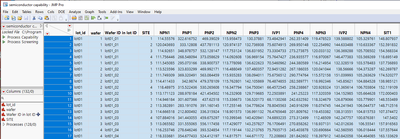

Hello,
I have a project and my purpose is to extract from my data table (1) the average, maximum and minimum value for each column, and write the results into a new table (2).
I found this part of the code and it seems to work for few columns, but not for all. I have like 300 columns and I have the results for only twenty of them.

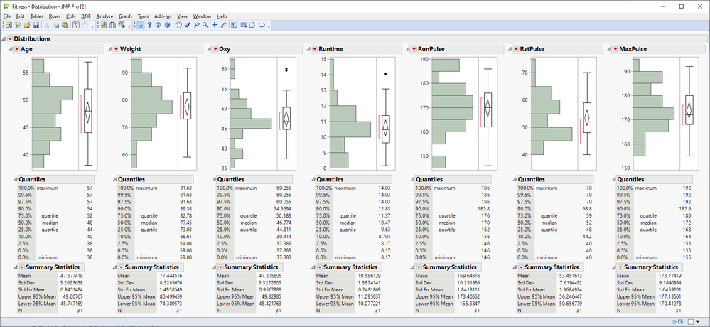

You can get what you want using JMP interactively. I will illustrate with Fitness from the Sample Data folder. Assume that the data table is open.
Step 1: Compute statistics
Launch the Distribution platform with all the data columns of interest (Age through MaxPulse).

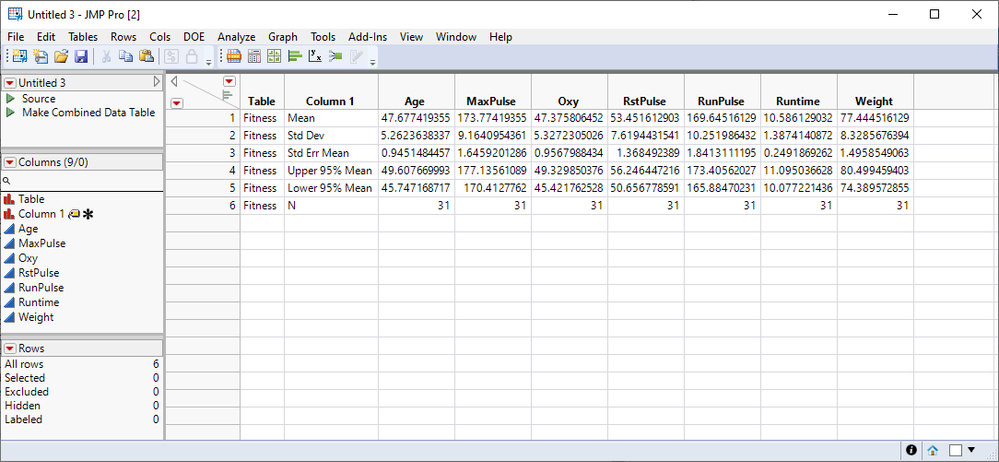

Right-click on the Summary Statistics table and select Make Combined Data Table.

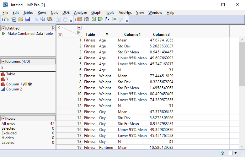

Step 2: Re-arrange results the way you want.

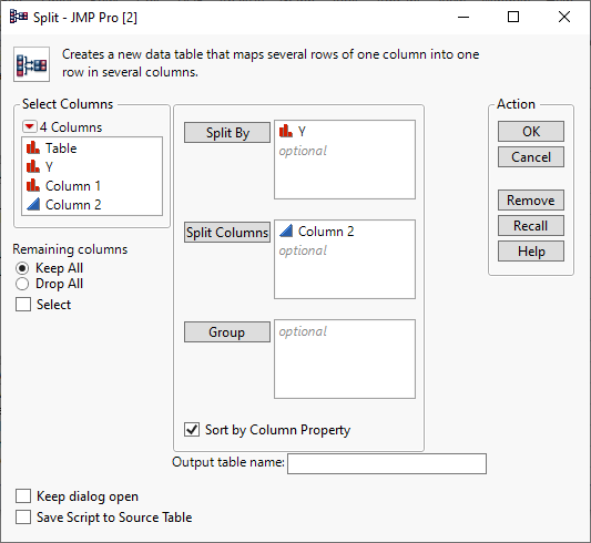

Select Tables > Split. Select Y column and click Split By. Select Column 2 and select Split Column. Select Keep All. Click OK.
I mean only to illustrate a quick, interactive process. It can be captured in a script as @txnelson suggested. It can be customized at each step as necessary.
