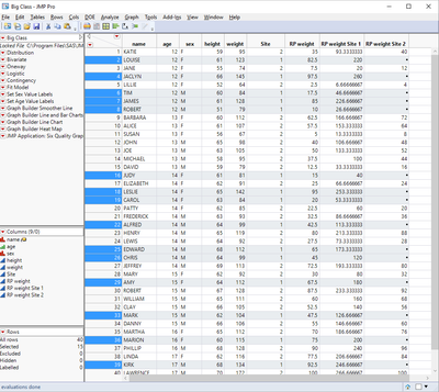

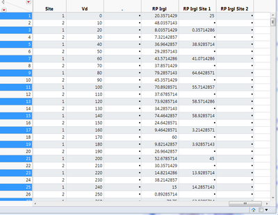

Thanks for getting back to me.  Unfortunately, the code still is not working
I noticed that in the code you sent me that you didn't add an exclude(1) under the Site 2 selection.  I added it, but unfortunately it did not work.  I attached a screen show to show you what my data table looks like.  The first two rp columns are what I want, but the last one doesn't have any values.
