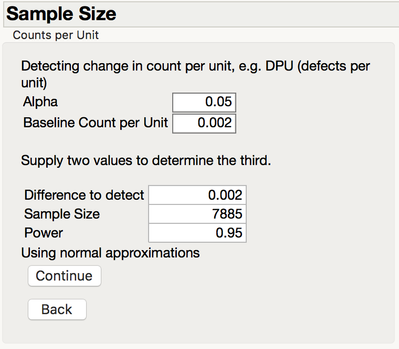

I’m using JMP Pro 12.1 and have questions that I hope you could help on using JMP to answer them.
Product runs are generating defects.
Mean defect rate = 0.002 (average 1 defect every 500pcs)
Std Dev = 0.01
1. What is the probability of finding at least 1 defect when I random sample 500pcs?
2. What is the minimum sample size I need to sample in order to get at least 1 defect at Alpha = 0.05
3. Is Alpha = 0.05 equivalent to 95% Confidence Interval?

try this:
Counts per Unit
to get to the platform from the main menu: DOE >> Sample size and power >> Counts per unit.

Re: Minimum sample size question
Thanks Ron!
From the calculations, I would need 7885 samples to get at least 1 defects at a 95% C.I.
you are welcome @cal_Iim
if this an academic exercise than alpha of 0.05 and power of 0.95 are in place. if on the other hand you need to actually do this to save money in a production scenario i would choose these values based on cost/ benefit. for that you need to know how much does each fault cost to the firm.
in most production cases i came across, 0.05 was  very far from optimal (too high or too low).
best,
ron
