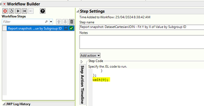

It JSL scripting it happens, where we may need to add "wait (0)" to let step complete before it moves on to the next step.
In the workflow step, you can edit the workflow script by adding wait code so that you don't need to manually pause it.
wait(0);
Example,

For formulas you should use dt << Run Formulas() instead of wait(0) as it is its purpose and use wait(0) for other waiting tasks (usually).

I added a WF step with just Data Table( "Source_table" )<<RunFormulas; after the step that defines the formula, and that is doing the trick.
