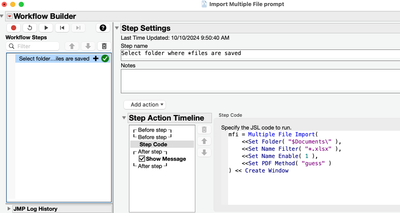

Re: Work flow builder
you can do something like this with MFI - creating a window to let you select a file type -- but for now these stated methods are the workarounds we know about.  Thanks.
