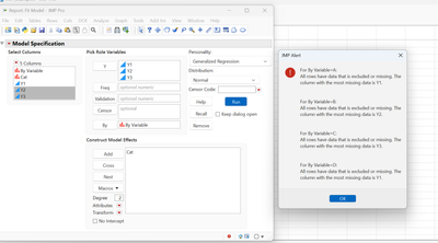

As you can see in the screenshot below: if I choose "Generalized Regression" only an error message pops up. If I click "OK" nothing else happens. No window opens.

Hi @AnjaW : It appears the issue I identified is not completely corrected (and I was able to replicate your issue with v18). I suggest you contact JMP support ([email protected]), and when you do you may want to provide a link to this thread as well.
