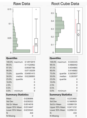

I am working with cell counts derived from tissue biopsies that exhibit an unusual distribution: some biopsies have no cells (zero counts), while others have low percentages (see example below). A simple Root Cube transformation yields a decent distribution of non-zero counts, but the overall distribution of the transformed data remains zero-biased.

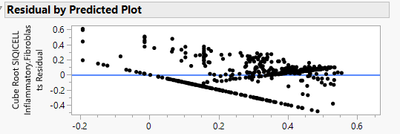

As expected, if I use this data in a Standard Least Squares Fit Model, the Residuals are not normally distributed (see below)
What would be your recommendation to test if these cell counts are associated with multiple covariates, including interactions?
Notes:
  1. The absence of cells (zero counts) is scientifically meaningful.
  2. I cannot easily share the actual data due to sensitivity.
Thank you.

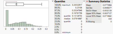

Thank you for helping me with this problem. Unfortunately, I do not have access to JMP Pro at this time. Still, I have access to the Generalized Linear Model in JMP 19 "Basic", but the Poisson Distribution does not seem to fit all the data. Indeed, when the cell type is more abundant, the non-zero sub-population distribution tends to approximate a normal distribution.
I wonder if binning the data as an ordinal variable could help here?
