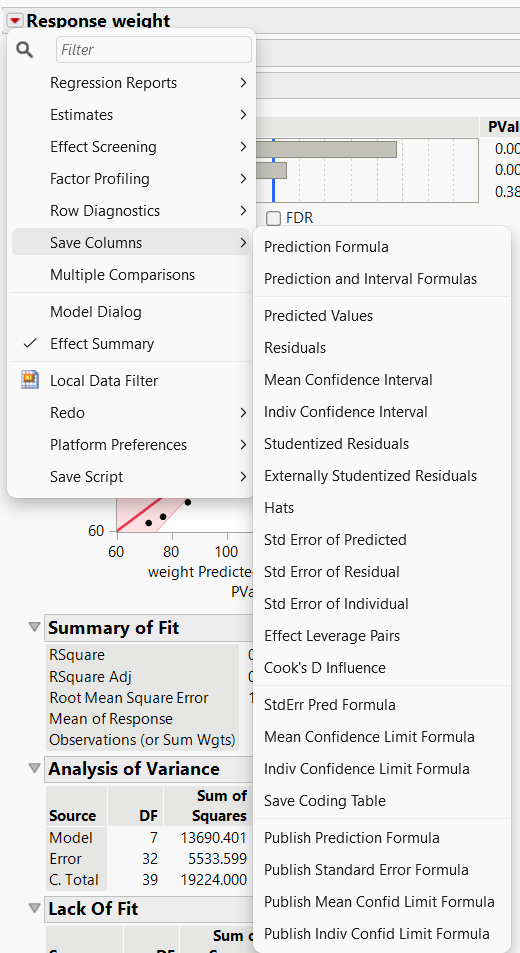

Re: Question About Accessing Underlying Data from Analysis Plots
Please see the documentation for the Fit Least Squares platform regarding saving data columns with regression results.
