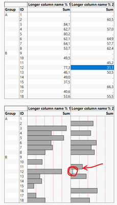

Hi All,
For the first time, I attempted to use the plot in tabulate.
However, the bars in the chart do not seem to represent the data very well...
Am I misunderstanding something?
"Bar chart" in tabulate
Bar chart in graphbuilder
Also, it doesn't seem to allow me to resize the table in any other way than by making long column names.
Hence the weird naming XD
I have also attached the data for you to try out.
cheers, Christian

Re: Wierd "bar chart" in Tabulate
I've never looked closely at this before, but I believe the only difference in your bar charts is the scaling.  There is a button in the tabulate window to change the scaling of the graph and I think that can be used to manually make the graphs match.  For example, if you set the minimum to zero in both graph builder and tabulate, I think the graphs will match up.
That worked perfectly!
There was a "Change Plot Scale" option that I missed.
Thanks for your help
