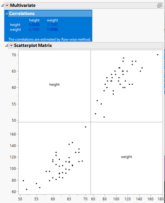

I was playing along with a Discovery Summit video on interacting with Report layer objects and came to a crashing halt on my very first example I tired.
Here I am trying to select the Correlation outline box but this ends up selecting the entire Multivariate analysis.  I've tried a couple of different approaches and can't get it work out so humbling asking for some input!

Want this:

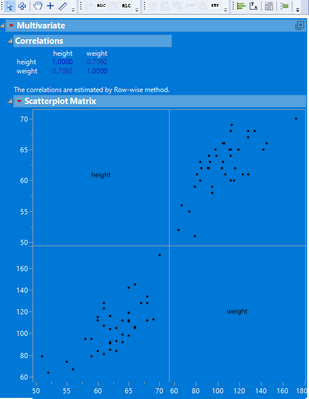

Getting this:

You got it right, but your attempt to double-check was misleading : )
To select the outline boxes which are returned by the Xpath command, use:
(obj<< XPath("//OutlineBox[text()='Correlations']"))<<select;
Without the  additional brackets, you will send the select command to obj.
