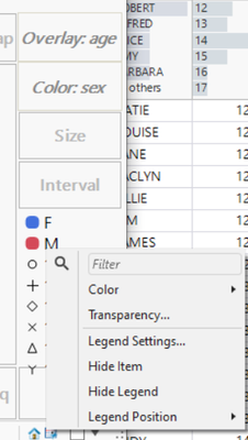

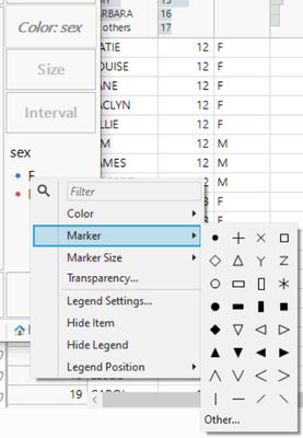

The second surprise: "Color" can do more than just "color":
For every entry in the legend, the user gets the possibility to define the Marker Style as well - as well as Size and Transparency.

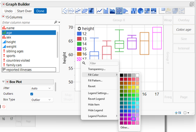

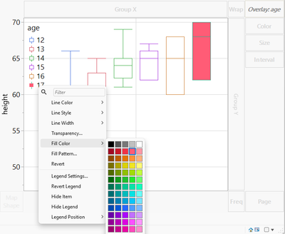

Overlay
Dropzone:
The user can adjust the Line Color and the Fill Color for every item:

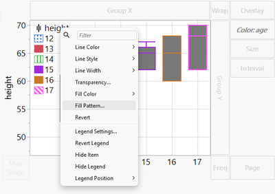

Color Dropzone:
- it says Fill color, but Graph Builder changes the Line Color.
What is the purpose of Fill Pattern?
no effect (A)  - there is not even a fill pattern:
*) no effect (B)  - after applying a Fill Color via the "box plot" settings:
[please note the difference between the legend and the plot]

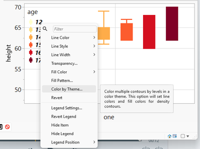

Issue with Overlay    and   Color by Theme:
The color is applied as Line Color and as Fill Color:
Is there a trick to adjust the line color only?

Color is much more than just "Color", see :
Why is this DropZone called "Color"
@hogi wrote:
Day 1 ...
zoom out view:
For Color together with Overlay, you are right.
Overlay takes away most of of Color's superpowers - just Color and Transparency are left:
