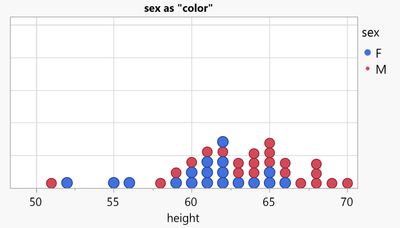

Now let's generate another points plot - where there is a difference between Color and Overlay:
Color just adds color to the points, Overlay generates separate plots for every color, overlays them
- and by doing so: hides some girls. -> dangerous!

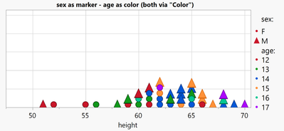

Let's keep the plot as a stacked bubble plot, and with the findings from surprise #2, let's now define Markers for different values
... with the help of the Color Dropzone

Day 3: The user likes the non.overlapping points, wants to add some Color (via age)  .. and get the legend right.

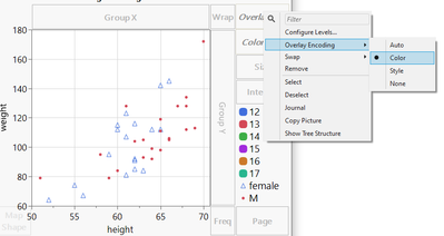

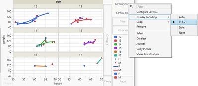

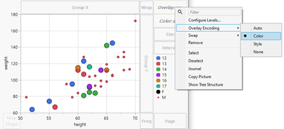

Did you know that Overlay Encoding can be used to Overrule the Color Dropzone:
[age used for the Color Dropzone - but the Overlay encoding is set to Color
- so, color of the points is determined by the Overlay settings, NOT by the Color Dropzone.
changing the color settings for age doesn't have an effect on the colors of the Graph]
Names Default to Here(1);
Graph Builder(
	Variables(
		X( :height ),
		Y( :weight ),
		Overlay( :sex, Overlay Encoding( "Color" ) ),
		Color( :age )
	Elements( Points( X, Y, Legend( 1 ) ) ),
	SendToReport(
		Dispatch( {}, "400", ScaleBox,
			{Legend Model( 1, Properties( 6, {Marker( "Triangle" )}, Item ID( "female", 1 ) ) )}

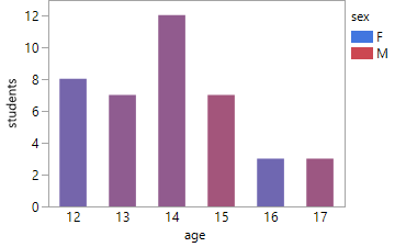

This rule holds ...  till you use BLACK as Overlay color:
IF Overlay color is black, JMP will use the color from the Color Dropzone - despite Overlay Encoding = Color.

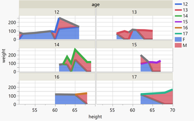

Another case where the above rule doesn't hold: Smoother, Bar, Contour , Box Plot  & Line graphs *)
For Smoother and Line Graphs, the COLOR Dropzone controls the Color, independent of the Overlay Encoding for the Overlay.
This fact can lead to plots with inconsistent color settings:
*) Please note:
Line of Fit and Ellipse  behave like points [but without the possibility to switch to Color by setting the Overlay color to black]
Area Graph seems to be a combination of both worlds:
