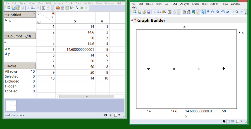

Can you share the data and a picture? I see this, table attached.
ordinal (green ascending stair steps icon)ordinal (green ascending stair steps icon)
Craige

Sorry to re-open an old thread here – I've had the same issue as Evan, and upon investigation, I find that with >50 distinct numerical values graph builder will make the axis continuous despite the column being set to ordinal. When there are fewer than 50 distinct values, the axis comes out ordinal as expected (matching Craige's observation).
Is there a way to control this behaviour? And perhaps more generally, is there a way to force graph builder axes to either continuous or ordinal, irrespective of the underlying data column's settings?
