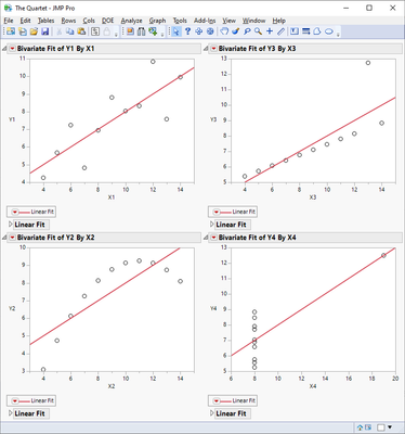

Anscombe's quartet
Anscombe's quartet (wikipedia) is fairly popular data set to demonstrate why data should be visualized. The data set consists of four different data sets that have almost identical descriptive statistics. The data set was constructed by Francis Ancombe in 1973. More information can be found from the article where they are demonstrated (Anscombe, F.J., 1973. Graphs in statistical analysis. The American Statistician, 27(1), pp.17-21.).
JMP also has Anscombe.jmp as one of the sample data tables. The data table includes table script "The Quartet" which will use Fit Y by X to demonstrate the data set.

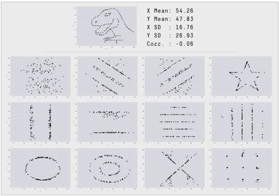

Datasaurus Dozen
I could see this as a bit nevere Anscombe's Quartet. You can find more information from Same Stats, Different Graphs: Generating Datasets with Varied Appearance and Identical Statistics th... . The idea of the article isn't exactly to demonstrate that visualization is important but rather how to create such datasets. The article uses Datasaurus dataset created by Alberto Cairo as the baseline for creating different plots.
Datasaurus dozen from Same Stats, Different Graphs (autodesk.com)

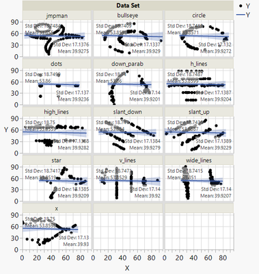

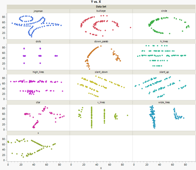

JMP already has JMP Man Dozen.jmp sample data which has been built from JMP Man by using methods suggested demonstrated in Matejka, J. and Fitzmaurice, G., 2017, May. Same stats, different graphs: generating datasets with varied appearance and identical statistics through simulated annealing. In Proceedings of the 2017 CHI conference on human factors in computing systems (pp. 1290-1294).
JMP Man Dozen dataset visualized in Graph Builder

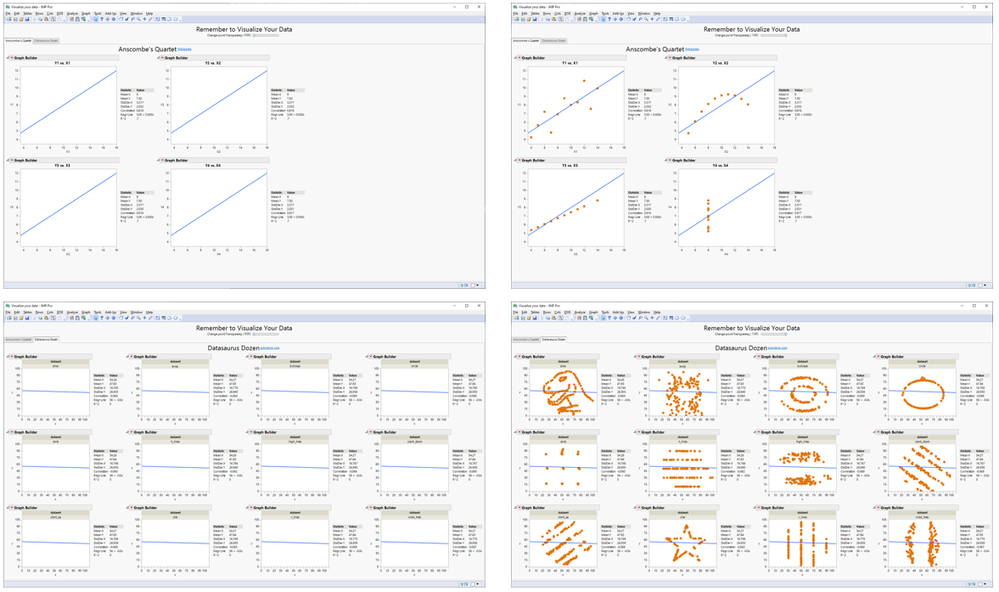

I "quickly" wrote a demo script which can be used to show Anscombe's Quartet and Datasaurus Dozen. This has been attached as a zip file to this post. Unzip visualize_your_data.zip to one folder and run demo.jsl and it should open a window with both data sets visualized.
The demo window includes slider which can be used to make markers more visible on all graph builders. Images on the left side have markers hidden and the ones on right side have transparency set to 1 (100%).

I like this one (from sample data)
dt = Open( "$SAMPLE_DATA/JMP Man Dozen.jmp" );
dt << runScript("Trellis with Summaries");
jthi
Re: Remember to visualize your data
Seems that JMP Man Dozen.jmp  data table is JMP's implementation of datasaurus dozen using same paper I mentioned in my post. Didn't even know that existed, so thanks for showing that @hogi !
