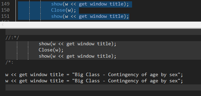

Your closedOK will be set 1 because of this and then it will skip your fallback
If( forceCloseNoPrompt,
	Try( Close( w, No Save ); closedOK = 1, closedOK = 0 );
	Try( Close( w );          closedOK = 1, closedOK = 0 );
You could change your check to something like !Is Empty(w) for example
