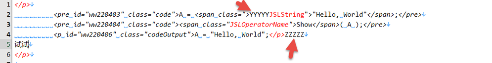

But the complicated ones don't:
For example, this JSL download txt
How can I match <">JSLString"> across multiple lines before the first </p>?
Replace it with something like this.txt has many places like this, need to use JSL implementation.

JSLString.+?</p>

However, the section about JSL code in the help document does not need to be translated, want to use the keyword
"JSLOperatorName" in the web source code, and the first </p> after it to mark the scope of the code that does not need to be translated.
Since sections of JSL code on the same page may span multiple lines, JSL regex is used to automatically recognize tags.
