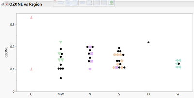

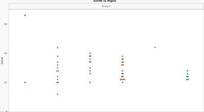

Hello,
I have been able to work on a script to edit the legend, based on a Flag column. When I recreate the same plot in GraphBuilder, I get a darker shade of colors, but when I run my script, it gives me a faded shade than normal. Why is this? I know it is something related to rows being selected, and the GraphBuilder just highlights those rows or cells. I have tried incorporating
dt << Clear Column Selection();
dt << Clear Row Selection();
but it does not work. The original plot
and the faded plot

It's shaded because you selected some rows.
May be you can share the Log to check if there's any issue with the script to clear the selection ;
or try;
dt << Clear selection;
dt << Clear Select();
2 REPLIES 2

Kenobi
Level III
Re: Why do the colors of different other points fade away in Graphbuilder?
Yes, you are indeed correct. I checked my logs and the error is in the line
Can confirm
dt << Clear select;
works! Thank you very much.
