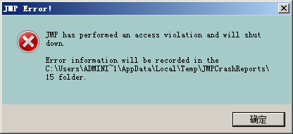

The following JSL build validation operation(Make Validation Column) with JMP 15 has an error.But this code works fine in version 14.
dt = Current Data Table();
dt<<Make Validation Column(Training Set(0.34),Validation Set(0.33),Test Set(0.33),Cutpoint(:code));
How to modify JSL, thank you!

I can confirm that this is a bug in JMP 15 that will be addressed in JMP 16.

I think I can reproduce this problem if the :code column is not continuous.  Is that the case in your example?  Can you turn it into a continuous column to work around the problem?
