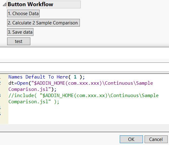

Hi, I'm new and need some help. I've learn how to create script button at jrn and manage to automate t test comparison manually. However, I already had addin Data Comparison which is much more easier for me. Somehow I want to make the script button to open the addin selection. my current jrn button script is like this,
it open from origin path of addin (view -> home folder jsl)
I read somewhere in forum that I need to include this line:
include( "$ADDIN_HOME(com.xxx.xxx)\Continuous\Sample Comparison.jsl" );
but it seems not working in my jrn. NEED HELPP how to automatically run the jsl from addin through jrn.
so I try to do something like this:
Names Default To Here( 1 );
dt=Open("$ADDIN_HOME(com.xxx.xxx)\Continuous\Sample Comparison.jsl");
it can open but cannot run the script. Does anyone know why? NEED HELP

correct me if I'm wrong but does the button script be like this?
dt << Include( "$ADDIN_HOME(com.xxx.xxx)\Continuous\Sample Comparison.jsl" );
I try the code above,but it will only open the .jsl window but cannot run on .jsl window and cannot automatically run it.

No, just use
The << operator sends a message on the right side to the object on the left side. That's not what you have.
dt = open(...)
is appropriate if the file is a JMP data table (.jmp file) and dt becomes a reference to the opened table. That's not what you have either. Open can open many file types; opening .jsl results in an editor window.
Include(...) runs the .jsl file. Include() is a function, not a message.
