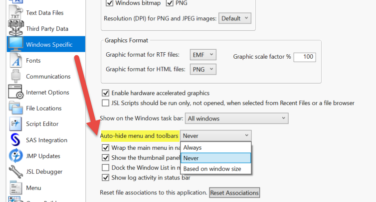

In JMP 15 and earlier, the pull down menus were minimized behind either a bar across the top of the display window, or else a bar with three dots on it. When the bar is clicked on, the pull down menus appear.
@SymetricFrog342 If you are on Windows, navigate in JMP to File -> Preferences -> Windows Specific and check the settings for Auto-hide menu and toolbar if this is set to Always or Based on Windows Size. If you change the setting to Never the menu is always present.
Screen capture from JMP 16.2:
Otherwise open a Tech Support case by emailing the issue to [email protected]
