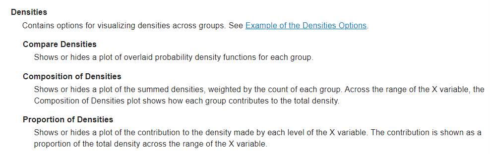

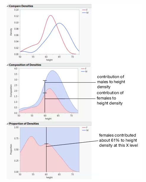

Usually when trying to figure out what is going on in JMP report:
  1. select "?" from toolbar
  2. click with "?" mouse pointer on the part of report you wish to know more about
  3. Help page will open (hopefully) in correct location
https://www.jmp.com/support/help/en/17.2/#page/jmp/the-oneway-platform-options.shtml?os=win&source=a...
Example of the Densities Options (jmp.com)
-Jarmo
