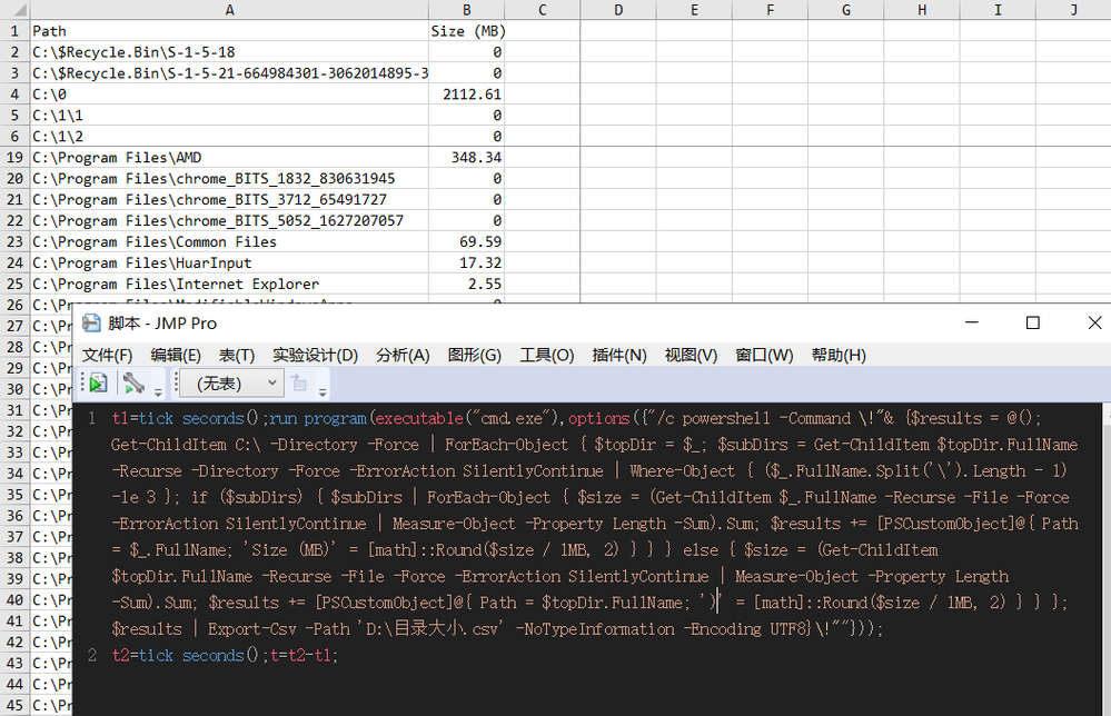

lala
Level IX
Re: How can get the volume of a specified folder directly using JSL?
Now GPT-4o is very powerful, it can do ordinary programming:
In the win10 system, the volume size of each directory of the C disk (including hidden files), the specific requirements are:
Starting from the root directories of drive C,
1, if the subdirectory of this directory is more than 3 layers, it can be expanded to the third layer directory, statistics of the respective volume of each directory contained in the third layer directory
2, if the subdirectory of this directory does not exceed 3 layers, the statistics of the expansion of this directory to the last layer of the directory of the respective volume
t1=tick seconds();run program(executable("cmd.exe"),options({"/c powershell -Command \!"& {$results = @(); Get-ChildItem C:\ -Directory -Force | ForEach-Object { $topDir = $_; $subDirs = Get-ChildItem $topDir.FullName -Recurse -Directory -Force -ErrorAction SilentlyContinue | Where-Object { ($_.FullName.Split('\').Length - 1) -le 3 }; if ($subDirs) { $subDirs | ForEach-Object { $size = (Get-ChildItem $_.FullName -Recurse -File -Force -ErrorAction SilentlyContinue | Measure-Object -Property Length -Sum).Sum; $results += [PSCustomObject]@{ Path = $_.FullName; 'Size (MB)' = [math]::Round($size / 1MB, 2) } } } else { $size = (Get-ChildItem $topDir.FullName -Recurse -File -Force -ErrorAction SilentlyContinue | Measure-Object -Property Length -Sum).Sum; $results += [PSCustomObject]@{ Path = $topDir.FullName; ')' = [math]::Round($size / 1MB, 2) } } }; $results | Export-Csv -Path 'D:\目录大小.csv' -NoTypeInformation -Encoding UTF8}\!""}));
t2=tick seconds();t=t2-t1;
