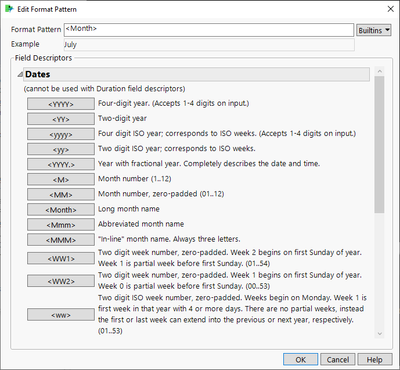

You could use Format Pattern
Names Default To Here(1);
opt1 = Format(Today(), "Format Pattern", "<Month>");
opt2 = Format(Today(), "Format Pattern", "<Mmm>");
show(opt1, opt2);
show(opt1, opt2);

Yass
Level IV
Re: Get month name so i can display it
That works perfectly, thank you !
