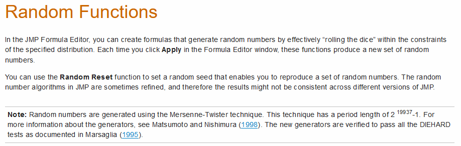

jthi
Re: Which algorithm to create a random order of runs?
This might provide some information regarding the random number generators JMP uses Using JMP > Reference for JMP Functions in Formulas > Random Functions (I'm not sure if this holds true for platforms though)
You might be able to find additional information from DoE Technical Details or References https://www.jmp.com/support/help/en/18.0/index.shtml#page/jmp/technical-details.shtml# . You can also contact JMP Support if you wish to, they will then contact (if needed) JMP developers.
-Jarmo
