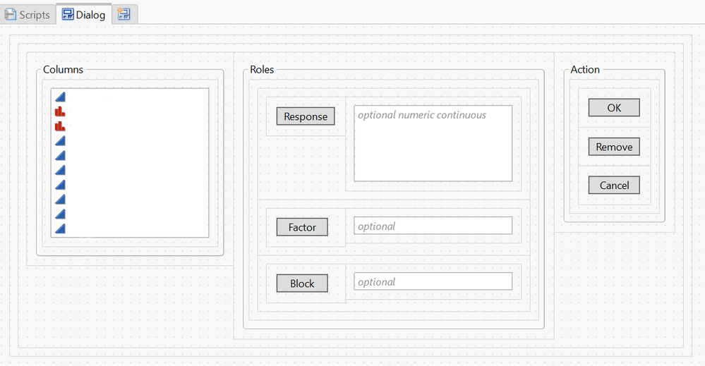

I am trying to develop a JMP add-in for the first time using the application builder, but got stuck with the JSL scripting as described below:
Some Background:
The interface was built under the Dialog tab.
There are three panel boxes with the titles of Columns, Roles and Action, and variable names of ColumnsPanel, RolesPanel and ActionPanel, respectively.
Under Columns panel, I added a Col List Box (All) with the variable name of ColList where it pulls into all the columns in the opened data table.
Under Roles panel, I added three Col List Boxes and three Button Boxes:
the variable names for the first, second and third Col List Box are ResponseColList, FactorColList and BlockColList, respectively.
the variable names for the first, second and third Button Box are ResponseButton, FactorButton and BlockButton, respectively.
the titles for the first, second and third Button Box are Response, Factor and Block, respectively.
Under the Action panel, I added three Button Boxes with the titles of OK, Remove and Cancel, and variable names of OKButton, RemoveButton and CancelButton, respectively.
When I click the Response Button, it added the columns of attribute "A", "B", "C", "D" and "E" from ColList.
Similarily, when I click the Factor and Block Button, it added the column of "Site" and "People" from ColList.

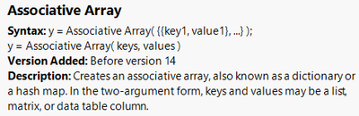

The associative array - with a data table as first argument?
Names Default to Here(1);
MET = Open( "$SAMPLE_DATA/Big Class.jmp" );
Factor={"height", "weight"};
Associative Array(MET, Column(Eval List(Factor)))
