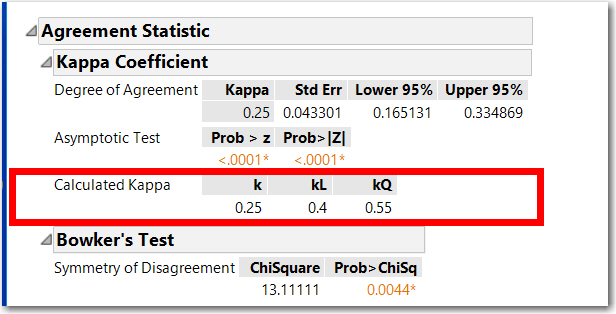

  • The value of k, kL and kQ are appended to the JMP report (see below).
  • The calculated kappa is reported as a check since it should match the kappa reported by JMP

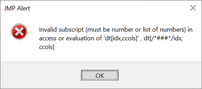

For some reason i get an error when running the script. i am using JMP 14.2.
any clue how to fix it?

this is what i get using the example file Slide58, not my own data. it also produces the same error on JMP11 and JMP 15.
all i did was open the file and run the script.

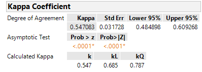

Sorry for the late reply. I ran the weigthed Kappa script while your subset table was the current data table. I specified BP1 as Y and BP2 as X. the results are attached as a .jrn file. Below is a snippet.
When you run the script:

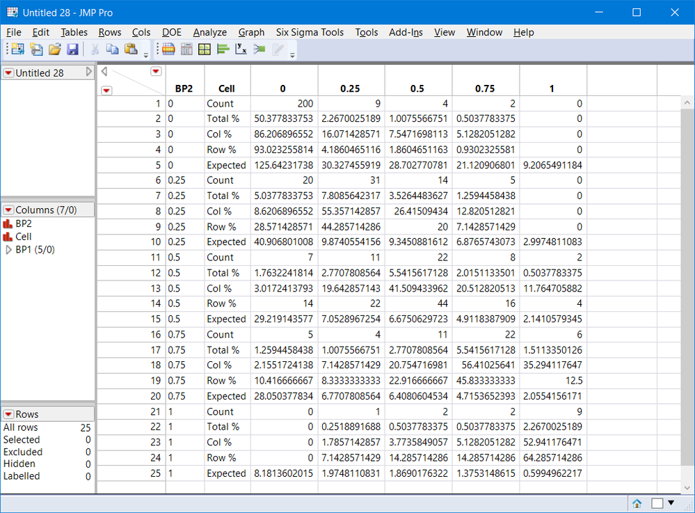

  • does the contingency table contain Total %, Col %,  Row % and Expected?
  • I suggest you comment out line 88 of the script that deletes the table made from the contingency table. Then run the script.  Does a table get created and does it look like this?
The error you reported appears that it cannot execute  cmat = dt[idx,ccols];  idx is an index of rows where Cell == "Count"  or later "Expected" and ccols are continuous columns which should be the list {"0", "0.25", "0.5", "0.75", "1"}. If the Cell names are not the same, maybe an extra space or something it could throw off the script, maybe a more robust solutions is to use where Contains(:Cell, "Count")
Just guessing here.
